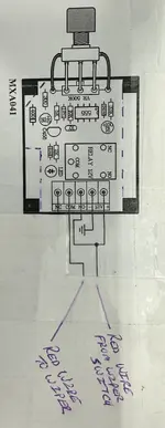

So, I've only had mine for a month or so, but it became apparent to me that a delay windshield wiper option should exist. After lots of digging I didn't find anything on the aftermarket setup....so I started doing some additional research on how to make this happen. For anyone that wants to add this feature, I thought I would provide some advice.
It can be done...actually pretty simple once you have the parts figured out. It's pretty cheap to do also.
You'll need these parts from Amazon:
Delay - Amazon.com
Knob - Amazon.com
I found I had to grind down the circuit board in order to get it to fit in a switch opening. I also took liquid electrical tape and covered it completely to avoid any issues with it touching anything or corrosion moving forward. You can see it looks stock next to the standard wiper switch once installed. I cut the red wire coming out of the factory switch to tie in and then ran a ground wire up to the main buss bar to avoid any other cuts into factory wiring. The only "catch" to this is you get a very slight delay on the slowest setting. But you can adjust the rest of the delay with the knob up to 30 seconds. The wiper park feature works as it should. Really simple setup...and saves me a lot of messing around while driving.

Thank you this is awesome. Just ordered the parts. Just so I'm reading this correctly cut red wire coming out of the back of the wiper switch on the dash. Take that wire to the new Amazon delay PC board. Then take the other end of The Wire that I assume goes up to the wiper itself and attach that to the new Amazon delay PC board? Then just take ground wire to the Amazon board and it works? Seems too simple but makes sense. Power comes through the switch to the new Amazon delay board. Then out of the board up to the wiper. Dial controls the speed of 12 volt to the wiper.

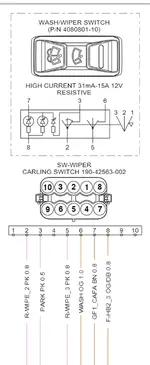

I must be missing something, 2024 xp2 Northstar. My wiper switch has 6 wires into it. 3 pink, 1 orange, 1 orange w/black stripe, and 1 brown. Where did you find a red wire to splice into?
Does anyone have an electrical schematic for an Xpedition? The pdf service manual that's available on this site does not have the schematics.

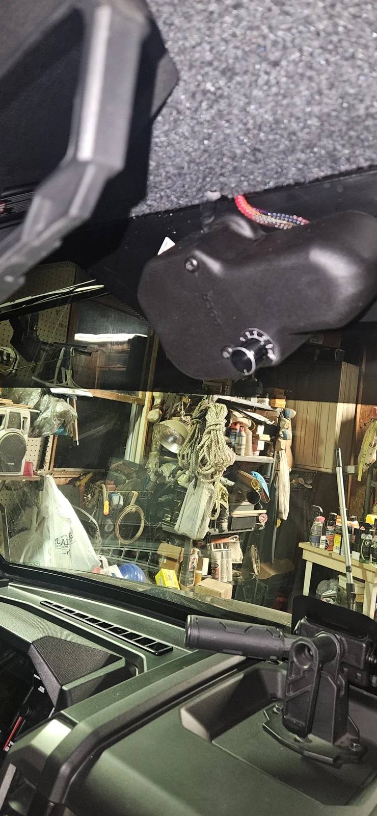

Id like to try removing the pot and wire the board separately in a protected enclosure. Concered weight of board on those solder joints over rough terrain

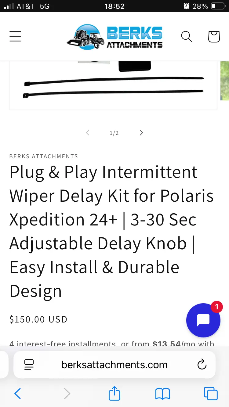

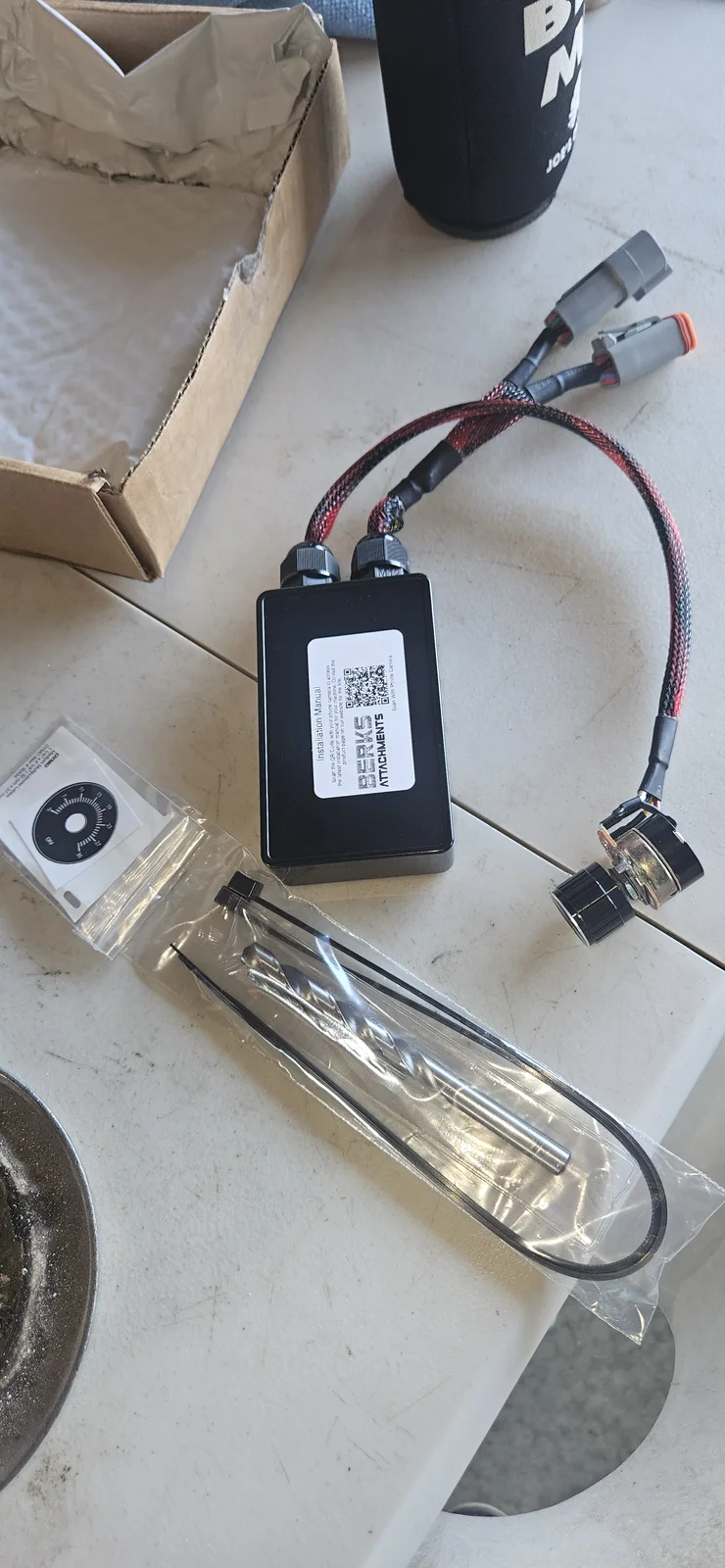

The Berks one is simpler but 150 bucks. Everything installs by the wiper motor.
